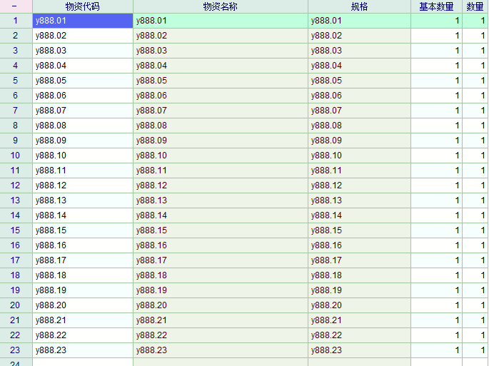

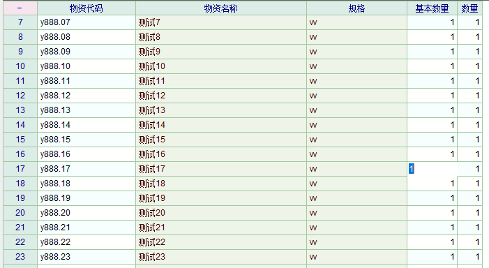

问题已解决,测试代码见三楼。谢谢summer老师

#3»发布于2017-07-01 08:50
谢谢summer老师,这是测试代码,问题完美解决
int main()
  string sql;
  int a, b;
  sql = "declare @v int";
  sql = sql + " select @v=count(1) from res_catalog where res_cat_id='2000'";
  sql = sql + " if @v=0 insert into res_catalog(res_cat_id,res_cat_name,order_id,batch_flag,cost_cal_method,edt_io_flag)";
  sql = sql + "values('2000','测试主用','2000','N','B','Y')";
  sql = sql + " select @v=count(1) from res_catalog where res_cat_id='3000'";
  sql = sql + "values('3000','测试产品组成','3000','N','B','Y')";
  db_run(sql);
  db_run("delete from res where res_cat_id in('2000','3000') delete from res_composing where note_info='测试用' commit");
  sql = "insert into res(res_id,res_name,res_cat_id,res_unit_type,res_spec)values('";
  sql = sql + "200','测试主产品','2000','B','测试') commit";
  db_run(sql);
  for (a = 100; a <= 150; a++)
    sql = sql + a + "','测试子产品" + a + "','3000','B','" + a + "测试')";
    db_run(sql);
    sql = "insert into res_composing(res_id,sub_res_id,note_info)values('200','" + a + "','测试用')commit";
    db_run(sql);
                dt_refresh_key("res",a);
  view_app_obj("res", '200');
